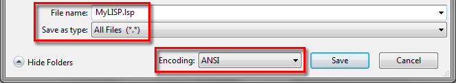

Lee Mac Posted February 14, 2012 Posted February 14, 2012 Set the 'Save as Type' box to 'All Files', with 'Encoding' set to 'ANSI'; ensure the filename has a '.lsp' extension: Quote
pjmac Posted February 14, 2012 Author Posted February 14, 2012 autocad is not finding it. Is there a way that i can see what autocad's search path is? Quote
Lee Mac Posted February 14, 2012 Posted February 14, 2012 Tools > Options > Files > Support File Search Path Quote
pjmac Posted February 14, 2012 Author Posted February 14, 2012 Thank you Lee Mac. That was my first time writing a program. Quote
