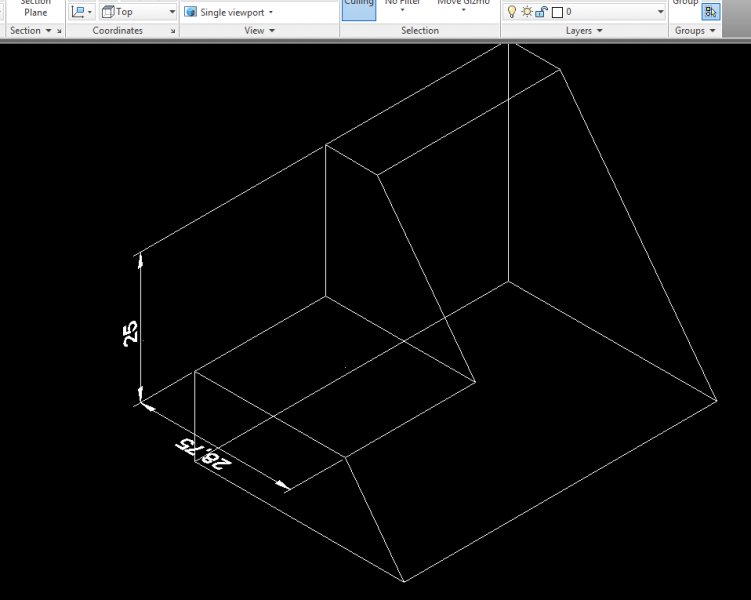

Mike G Posted February 19, 2012 Posted February 19, 2012 Hello, Is it possible to make a 3D drawing from 3 2D-views? I have 3 views, the leftside view, top view and front view. Drawing file is included to make it easier to see. Thanks in advance, Mike Oefening1a.dwg Quote
ReMark Posted February 19, 2012 Posted February 19, 2012 Without looking at the drawing I'd say that it could quite possibly be done by extruding each view in the proper orientation then run the INTERFERE command. I saw someone use this technique to model an electric guitar. I'm not on my CAD computer at the moment so I have no idea what the object is you are trying to 3D model. Quote
Mike G Posted February 19, 2012 Author Posted February 19, 2012 Something like this? Exactly something like that How did you do that? ^^ Can you record what you are doing with fraps or so? Quote
Dadgad Posted February 20, 2012 Posted February 20, 2012 Something like this? More like this, from your drawing, perspectives sorted out. :wink: Oefening 3D-1B.dwg Quote
khama Posted February 20, 2012 Posted February 20, 2012 It was quite simple really. Draw a rectangle and extrude it 40. Draw another rectangle 25 and extrude it. Position the second rectangle then subtract it from the first rectangle. Then slice the whole thing along the angle plane and your done. I will prepare a step by step soon and post it to you. Quote

SEANT Posted February 20, 2012 Posted February 20, 2012 The notch does not have the same dimensions as listed in the 2D drawings. Quote
khama Posted February 20, 2012 Posted February 20, 2012 In what sense.. It is 20 instead of 25.. big deal Quote

khama Posted February 20, 2012 Posted February 20, 2012 Seant you are politically correct. Here is the step by step. Oefening 3D Step by Step.dwg Quote
Dadgad Posted February 20, 2012 Posted February 20, 2012 If you looked at my revisions you will notice that you had the top and bottom views reversed, and the right end view was displaying the left end view, before I mirrored it. The approximation of the dimensions may not have been so much of an issue as those minor problems. In an open forum it is only natural to expect peer review, C & C. We are all pulling oars in the same striving to help the OP boat, or else we wouldn't be reading this. Quote

nestly Posted February 20, 2012 Posted February 20, 2012 For simple geometry like this, PRESSPULL and EXTRUDE are probably the way to go.... [video=youtube;X-ihGjVKIHg] Quote
Mike G Posted February 20, 2012 Author Posted February 20, 2012 If you looked at my revisions you will notice that you had the top and bottom views reversed, and the right end view was displaying the left end view, before I mirrored it. The approximation of the dimensions may not have been so much of an issue as those minor problems. In an open forum it is only natural to expect peer review, C & C. We are all pulling oars in the same striving to help the OP boat, or else we wouldn't be reading this. I think there is some confusion here. I'm using the european projection method and yours is the american one. @khama and nestly: Thanks for the step-by step guide. This makes everything much more clear. Quote
