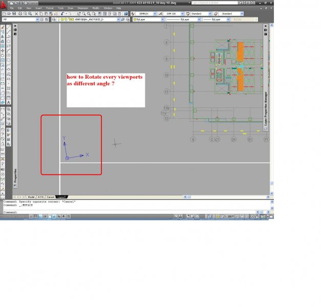

How to Set the Paper Space there create viewports in Different Angle ?
(please find the attachment file :)
how is the Step ? :oops:
Thanks :)

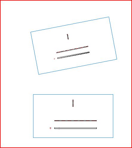

I am not sure I understand what you hope to do. This sounds like what you may be asking about would be a UCS/WCS issue. You should know that a viewport can be rotated, in case this might help.
If this is not what you want to do, then press your f1 key and search in the autocad help for UCS. :)

To align the view to current UCS may set the UCSFOLLOW system variable to 1 in that particular viewport.
