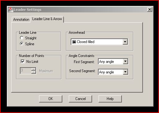

Dadgad Posted February 21, 2012 Posted February 21, 2012 Any suggestions as to how to change the default QLeader setting to match my personal preference, which is shown in my attachment? This really annoys me, whenever I have to do it manually. Quote
nestly Posted February 21, 2012 Posted February 21, 2012 Is that dialog box without an "Attachment" tab from AutoCAD2012? If so, how'd you get to it? Quote
Dadgad Posted February 21, 2012 Author Posted February 21, 2012 Is that dialog box without an "Attachment" tab from AutoCAD2012? If so, how'd you get to it? If you designate Annotation none, then the Attachment tab disappears. At the top of my game I do it with E.S.P. Quote

nestly Posted February 21, 2012 Posted February 21, 2012 QLeader settings appear to be saved in the drawing, so if you save it in your template..... Quote
Dadgad Posted February 21, 2012 Author Posted February 21, 2012 Good point stykface, I have messed around with multileaders a bit recently trying to answer a post for an OP, but typically I don't have much use for them. I did have the multileader toolbar open in my workspace for a few days though, and noticed that there were some pretty interesting options available there. I think I even saved a multileader style which I set up. I'll reconsider them, thanks for the input. Having been through all of the system variables I see that it would likely take .lsp to do it otherwise. Quote
Dadgad Posted February 21, 2012 Author Posted February 21, 2012 Thanks nestly, yeah you are correct, it uses whatever the last setting you used was. Which is fine in my templates, but when I receive drawings from other sources, I usually have to go in and reset that setting. I don't realize it until I start to draw a butt-ugly angular nonspline leader, and it annoys me and breaks my rhythm. Quote
