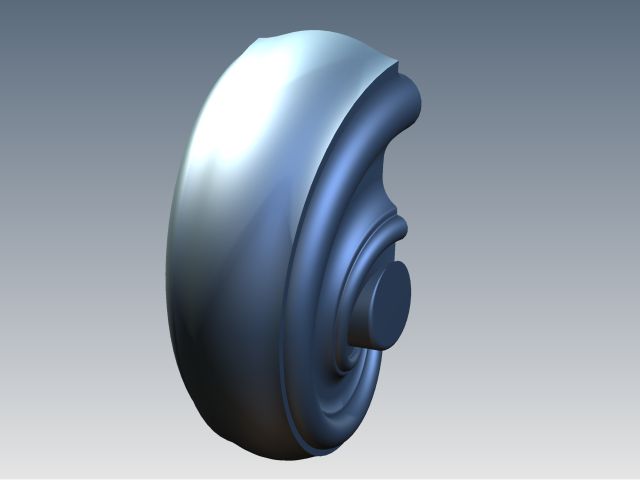

Any ideas or approaches of how I can better control the loft so that the central space of the spiral handrail is round or elliptical (I want to insert a central core)?

Amendment to above - the central space to be round.
Thanks D, I wasn't very clear in my original post - sorry about that, but I've managed to get a solution by sweeping with a central line of an arc and then extruding the core. Attached image shows what I was trying to achieve.

OK, thought you wanted to insert a corre for fastening to the rest of the handrail. Looks Good
