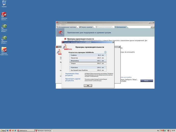

Test results for Windows Vista x64 SP2

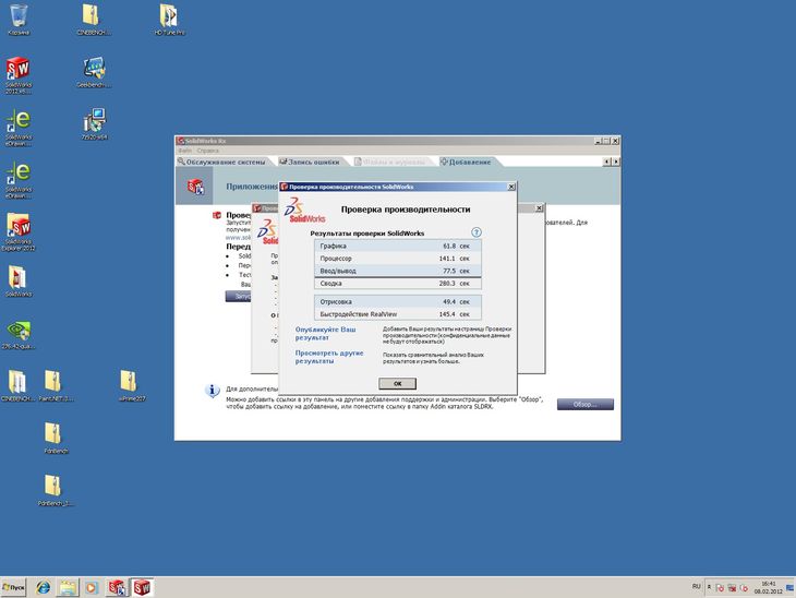

Test results for Windows 7 x64 SP1

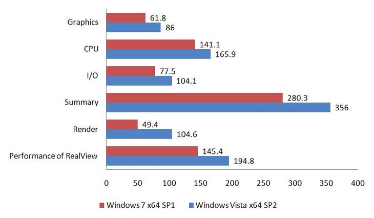

Diagram comparing the performance of Solidworks 2012 in the operating systems.

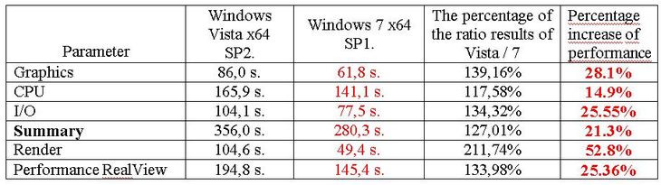

Summary table of results:
I've had pretty good luck so far using Win7. Vista is dead. If Im not mistaken, MS no longer supports Vista. Much like XP. Win7 would be the ideal environment. When I get a chance at home I'll see if I can dump some details for you.
I think the difference is more about how Win7 uses the system memory. There are so many setup factors that would influence these tests as well. I ran SW10 on vista on a fairly slow system with no issues. They for most things is going to be your processor speed. Several features in SW can make use of multiple cores. Things like Hyperthreading can have an adverse affect on performance in SW as well. Also note that the performance test runs different if you run it first when you start your computer.
Did you mess with anything in Win7 as far as performance settings? What about Vista? Do you have a paging file? Hyperthreading on or off?

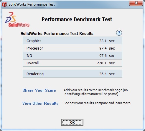

Just as a comparison on my machine I ran the SW benchmark with and without hyperthreading to see the difference. The bottleneck on my system is the memechanical drive. Im running a core i7 x980 overclocked to 4.15ghz. 12gb ram and a quadro 5000 graphics card.
I also did some post benchmark testing for motion studies and renders. With HT on i rendered a car in 4.5mins. With it off i rendered the same scene in 5.25mins. During my motion study the 6 virtual cores were parked so there was no noticeable difference in speed.
