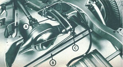

I always thought that '59 Impala was kind of sloppy in the suspension area when starting off and stopping hard. In fact, it was scary. Finally took it to a shop for new shocks one day. The tech discovered that the "Trunion Bar" had long since broken away from the frame but the other end was still attached to the axle. The rear axle subsequently was only located by the springs, shocks, a side 'locator bar', and the driveshaft. Wibbly wobbly is not strong enough to describe the result.
For those not in the know, a trunion bar is a single locator arm attached to the axle with a bolt and rubber bushings. See Part "A" in the first picture below.:lol: The other end is attached to the frame also with a bolt and rubber bushings. It is supposed to keep the axle located in the proper front to back position while letting it move up and down in relation to the frame.
The frame end bushing mounting plate had broken off at the factory weld. It had been broken off long enough for a much larger hole to rust into the frame where the break had occurred. There was so little material left, the tech had to weld a 4 x 6 plate to the side of the frame before he could fabricate a new mount for the trunion bolt to be welded on. The driveshaft had also trashed the center bearing due to all the fore and aft shifting under load, so it was replaced. All the repair work cost my Dad a whopping 83 dollars out the door. I really miss 1964. a lot.
The other picture is what the old Batmobile used to look like. Ours didn't have dual exhausts but the rest is identical.

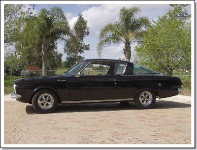

Wow, your Dad dropped $83 back in the day for the repair. I had to get my mind around how much money that was back then. It doesn't seem like a lot, so I ran it through the Consumer Price Index (CPI) Inflation Calculator. If he had the repair done today it would have cost him $587.23. I bet it would actually be more as labor costs are higher. My first restoration was a 1965 Plymouth barracuda. I sure miss that car.
