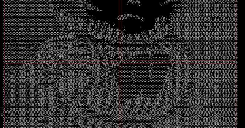

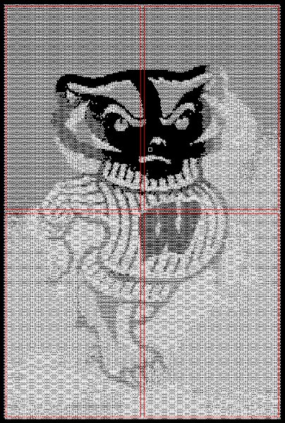

Attached is an example of what I am talking about.
This is one image that will be split into 4 different panels.
The panel edges are not shown.
The white circles are the holes.
The red rectangles are my borders of where I determine the holes I need to delete. I need to keep the holes fully inside each of the red squares.

Thanks for your help guys. No luck though... I changed the width of the line to .40" and did a "erase+'fs" command. It only deleted the circles that it touched in the very center of the line. The width of the line had no effect even though it covered all the holes i wanted to delete.
I also tried something different. I created a grid pattern using lines that touched all the holes that i wanted in the center and outsides. All the lines i drew were touching each other and the holes that i wanted to delete. I then turned fsmode "ON" and entered the command "erase + 'fs". For the most part it worked, but it still missed a lot of the holes ~25% or so and it also deleted huge chunks of the edge 4-5" inward that weren't touching any lines. I am assuming there is a glich in AutoCAD. I undid all the deleting and commands and started again, this time it deleted less holes and no large chunks from the edges.
