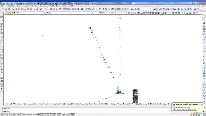

Hey I design conveyors, when im done I layout all the parts so i copy object and make a layer called parts. my question is can i layout a part without making a whole new part off the frame so there is not other items in the veiwports?
In the pic at the origin is my conveyor then i have all the parts duplicated a second time for layout in the veiwports.
Ist there a better way to do this?
Yes, but you'll need a layer for each part that needs to be displayed by itself in a viewport.
