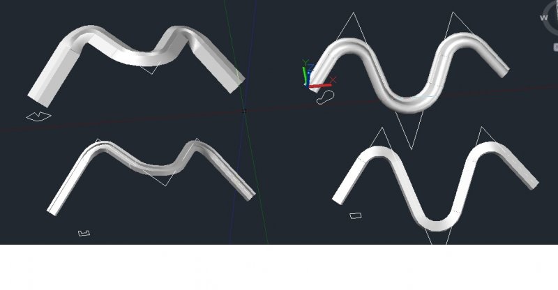

As a follow-up to this thread, I wish to post my autolisp for review in this section, which in my opinion could be useful.
This autolisp will create solids/surfaces in 3D or 2D line and curves. However, there are some limitations and also conditions to satisfy.
Please refer to header in the autolisp for more information.
The autolisp produce this:
SECT3D Autolisp
SECT3D.lsp

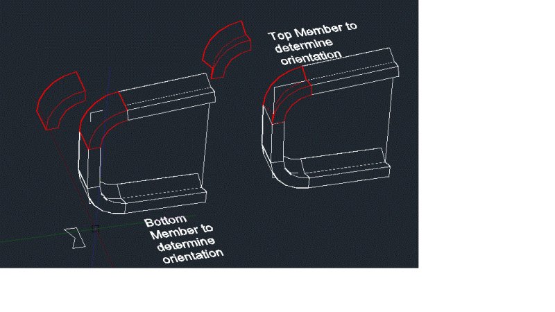

Hi Seant,
As you have aptly pointed out, the inclusion of sweep for vertical members would make the lisp better.
I have examined this option during the drafting of the lisp, which I then decided against its inclusion.
The reason being that the distortion or the twist in circular members between a vertical members at certain condition would make the sweep alignment visually wrong.
Have a look at the illustration in the accompany pictures
The red circular members must twist 180 degree to achieve the original requirement of the directional profile at Y-direction to be facing upwards, no matter which cue we take from either the preceding or subsequent vector
However, if you still wish to include vertical members, you can break the sweep runs, before vertical members and sweep vertical members manually using AutoCAD command.

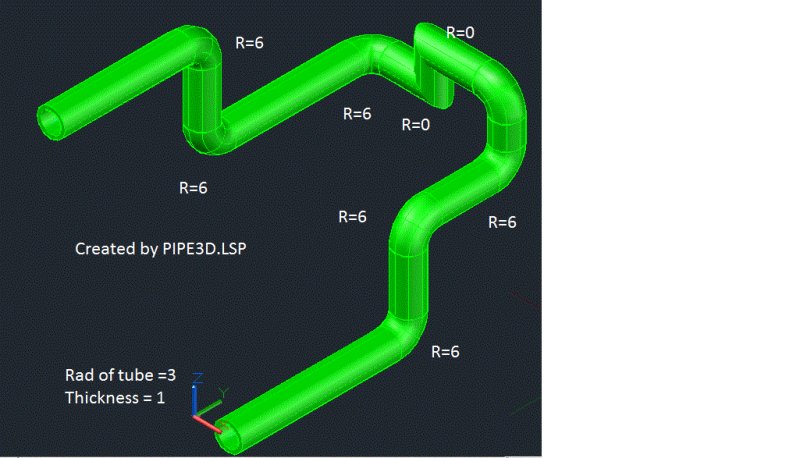

Meanwhile, please look into the attached PIPE3D.lsp. This is a sister to SECT3D.lsp, which is alot easier to code because of the symmetrical properties of circle, where twist is not a factor to consider.
I did a pipe run on your drawing using PIPE3D, and here is the result:
Please read header in the lisp for more information.
Let me have your comments.
