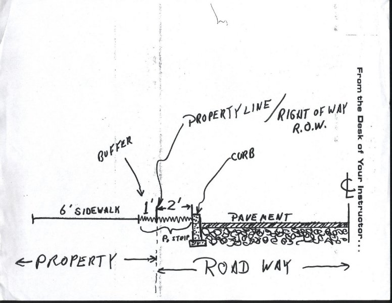

2). ROW, Sidewalk, and Curb location. The instructions here are very vague and confusing. I have mine on the outside of the ROW lines. 1ft from ROW then 6ft sidewalk, then 3ft parking strip, then curb. Does not seem correct to have the curb and parking strip on the other side or the side walk.

2) ROW, Sidewalk, and Curb location- Outside the ROW goes ROW- 1ft buffer- then 6ft sidewalk. Inside the ROW goes ROW- 3ft Parking strip to curb.

Sidewalks, grassy strips and curbs usually are shown INSIDE street ROW lines. P-F has two of the three on the outside and only one (parking strip) on the inside. Which means if you deduct 3 feet on both sides of the road for a parking strip the pavement is 46 feet wide. For a subdivision that just doesn't seem right. Now maybe if you were drawing a main commercial boulevard I could see it but not in this case.
Here is what they sent me. Thanks for the link, it has some good info. I have submitted my drawing to PF. Will let you know how I made out. The next module is on Structural and Civil drafting. I am looking forward to the Civil drafting project, as thats what I plan to try and get into.
Well despite what the instructor has given you I must politely disagree. Do it the way the instructor wants it shown and if you get any grief about it you have the evidence to back it up. Personally I think the "instructor" who answered your question does not have any civil background and is giving you his interpretation of the instructions. Remember P-F is grading you and not me.
