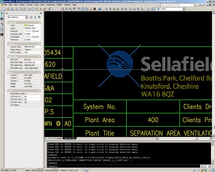

I have lines projecting out of a block when I paste it in, they look like a large x. Its been a long time since I have experienced this and have forgotten what the command is to reduce the lines, and ideas? :unsure:
I don't think I've run across this issue before. Can you post a screenshot?
Try setting PDMODE to 0 and see if that helps
