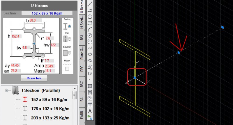

Good Day
Looking for Assistance
With the image above
I would like the user to select the line to insert the selected section and extrude it according to the line
Have to orientate the UCS perpendicular to endpoint of line, Insert the Section, and then extrude it the same as the line length chosen.
Just need assistance in defining the UCS's to the line??
Any help most appreciated
Thanks in Advance
Not tested :
Public Shared Sub UcsByLine(ln As Line)
Dim pt1 As Point3d = ln.StartPoint
Dim pt2 As Point3d = ln.EndPoint
Dim ed As Editor = Application.DocumentManager.MdiActiveDocument.Editor
Dim zAxis As Vector3d = ed.CurrentUserCoordinateSystem.CoordinateSystem3d.Zaxis
Dim xAxis As Vector3d = pt1.GetVectorTo(pt2).GetNormal()
Dim yAxis As Vector3d = zAxis.CrossProduct(xAxis).GetNormal()
Dim mat As Matrix3d = Matrix3d.AlignCoordinateSystem(Point3d.Origin, Vector3d.XAxis, Vector3d.YAxis, Vector3d.ZAxis, pt1, xAxis, _
yAxis, zAxis)
ed.CurrentUserCoordinateSystem = mat
'ed.UpdateTiledViewportsFromDatabase();
End Sub

Thanking You Kindly
My (Our) application is coming quiet fine
Apprecite your input again
