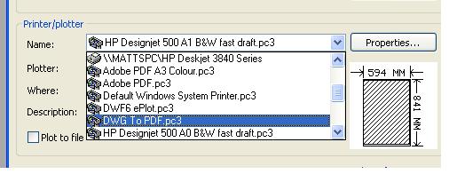

Does AutoCAD 2009LT have the supplied by AutoCAD DWG to PDF.pc3?

SLW is referring to the "DWG to PDF.pc3" plotter. Yes it should be there in LT 2009. Might have been 2010 but if I remember correctly, 2009 LT came with it.

go to plot and select dwg to pdf in the pull down
Well whatta ya know. That's better than sliced bread.

Be sure to use this with the PUBLISH command too. That way you can batch plot PDFs: you can do all sheets into one single PDF or each sheet as its own PDF. Helps a ton when you have multiple sheet drawings.
