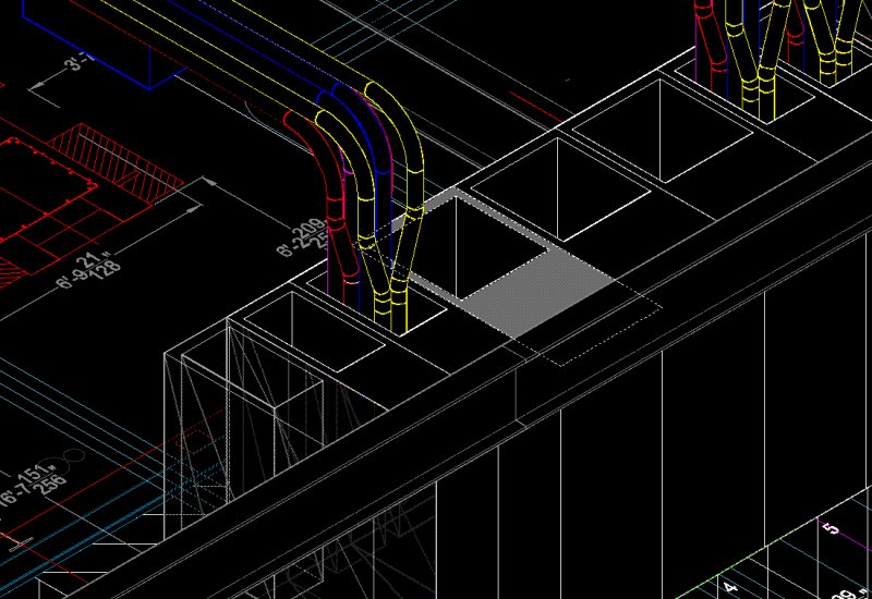

Hey guys, I've been running into this problem for quite some time and it is annoying. I'm using AutoCAD MEP 2011. I don't know if this makes a difference in regular ACAD or not... I've noticed that if the 'line' command is active and I drag my crosshair over the top of a 3D object the face of that object will highlight and this causes my machine to lock up and I have to restart everything. Is there a way to turn off this auto-selecting face attribute? PIC1.jpg
The picture above shows the face of the object being auto selected..this was right after my cad session locked up.
You want to disable face highlighting or selection preview?
In plain AutoCAD one can look on the Selection tab of Options. See also Visual Effects Settings.
I've noticed that if the 'line' command is active and I drag my crosshair over the top of a 3D object the face of that object will highlight...
I don't have MEP either, but since a Command is active, it could be SELECTIONPREVIEW as ReMark suggested above, or it could be Dynamic UCS (UCSDETECT), or a combination of both.
UCSDETECT worked like a charm! Thank you very much!
