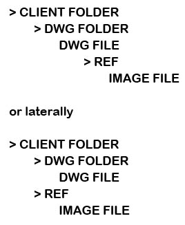

kmwhitt Posted March 2, 2012 Author Posted March 2, 2012 It is usually a tif or jpeg that I am using to trace over... The files/folders are consistent. I was under the impression that as long as these files were all in the same directory, AutoCAD would find them. This has NEVER been the case and the references have never been moved. Not even the hierarchy has been changed. Maybe I should clarify - The image file is not in the same folder as the DWG. It is under that folder in another folder named REF. It won't work with lateral relationships either. Maybe this in intentional, but I have always defined relatative path as meaning it could be found as long as the position of the file is the same in relation to the DWG no matter what the CPU. Thanks again, Kevin Quote

kmwhitt Posted March 2, 2012 Author Posted March 2, 2012 Here's an illustration of what I am trying to do... Neither case will work! Quote
