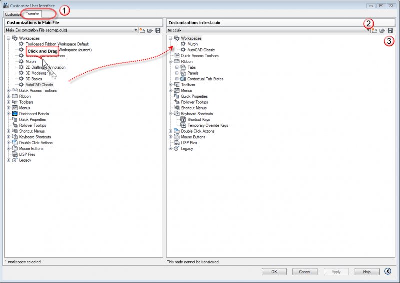

All you need to export or transfer is your workspace that you use. In the CUI use the transfer tab, create a new cuix, drag and drop the workspace then save. Watch where its save to.
Then in the new PC use the load partial cui to bring in that saved customized file.
