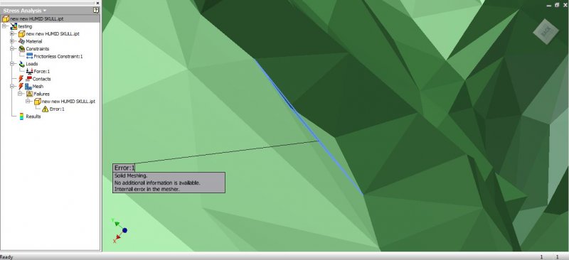

now that i successfully convert it to solid model. but this intersecting face drive me crazy. i tried all the repair methods but it just doesnt work. mind helping??
Attach your file, then people will be able to take a better look at it.
i cant upload the file even i had zip , 11 MB
