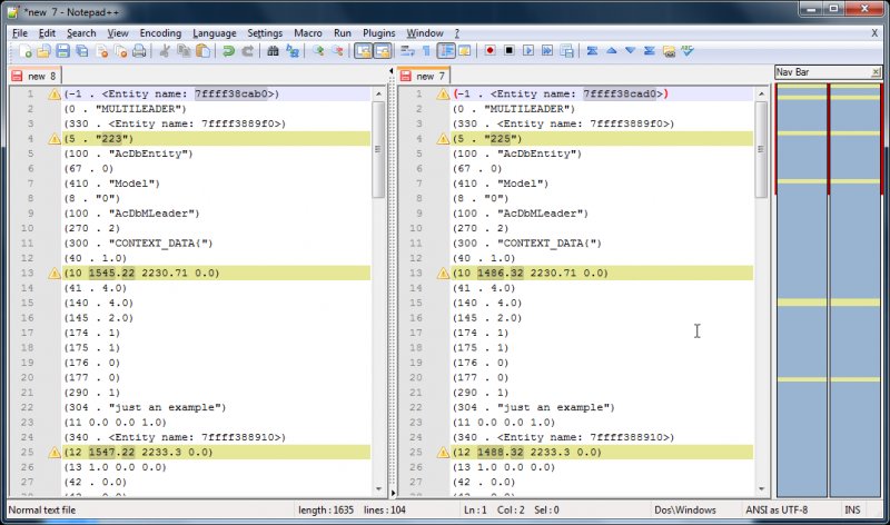

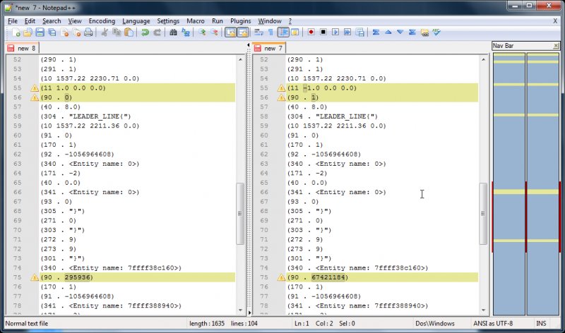

There doesn't seem to be any way of doing that with lisp straight-forwardly. I can't find anything in ActiveX (online version of help can be found here: http://entercad.ru/acadauto.en/).
But it appears that the DXF data shows the insertion point of the text. Thus you can place the text to the left/right of the leader line. The following are screen captures showing the differences of the DXF codes to 2 leaders (one with text left of line, the other with text right, both have the leader pointing downwards between the same two points, so the only difference is the text).
