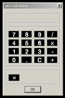

You can however use slide_image as buttons, a year ago i tried to create a DCL caculator just for the fun of it. i dropped the idea as I cant get around all those arithmetic functions especilly "divide" :lol:
Attached is my failed attempt, maybe you'll have better luck with it.

You're going to have to crate your own slides for some reasons it wont accept it here as attachment
HTH
