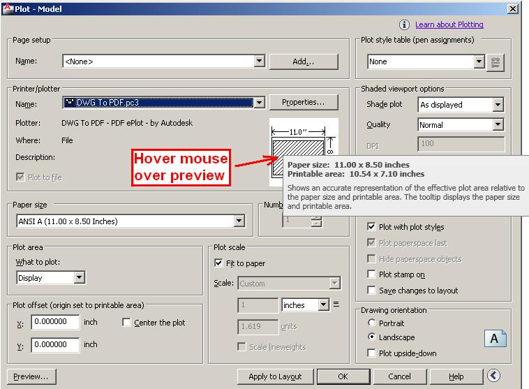

Mechanical Posted March 9, 2012 Posted March 9, 2012 Can someone tell me the most efficient way of inserting a title block (the border around a drawing with text etc) into a layout? Sometimes when I insert a title block it seems like the title block is too big or too small for the layout, any tips and help would be very welcome. Quote

nestly Posted March 10, 2012 Posted March 10, 2012 Insert the Titleblock in Paperspace. The title block should be just a bit smaller than the printable area of your paper. ie if you're printing on 8.5 x 11 paper, a titleblock that measures 8 x 10.25" would be appropriate. Quote

nestly Posted March 11, 2012 Posted March 11, 2012 (edited) Do you mean you want use a titleblock that's designed to fit on a larger paper? I hope not, because the detail is going to be too small to be usable. You should use or make a titleblock with dimensions that are just a bit smaller than the printable area (the dotted lines in the layout) Open the plot dialog box, select your printer/plotter, pick the paper size, then hover over the preview to see the printable area. Edited March 11, 2012 by nestly Quote

nestly Posted March 11, 2012 Posted March 11, 2012 ok, I am working with a title block that is slightly larger than the layout border, what is the correct method to shrink the block to fit the paper margin in the layout? Open the block with the block editor, and change the dimensions of the Titleblock border(s). Then save the block with a name that allows you to identify what size paper it's designed for. Alternately, if your titleblock is designed for a certain size paper, but your printer driver has an undersized printable area, you can just increase the size of the printable area in the plot dialog box Quote

rickh Posted March 12, 2012 Posted March 12, 2012 firstly, I agree with others that these should be set so scaling is not needed. If you do want to scale the inaccurate titleblock to be very accurate, then first draw a rectangle the same size as your paper size (ie full bleed pdf sizes for me are -.0625 from the named size. Full bleed 24x36 is an allowable boundary of 23.9375x35.9375. Look at the paper sizes in the print driver properties to see the size of the printable space for each paper size). let's say I draw this rectangle, then insert the titleblock to 0,0. Then select it, SCALE, pick 0,0 as basepoint, select R for reference, pick 0,0 again, then pick the right corner of the titleblock, then pick the right corner of the rectangle. It's as precise as you can get - one rectangle, one scale with reference points. It would be the same idea with a dynamic block (didn't watch the vid but I think I get the jist of it). Quote
