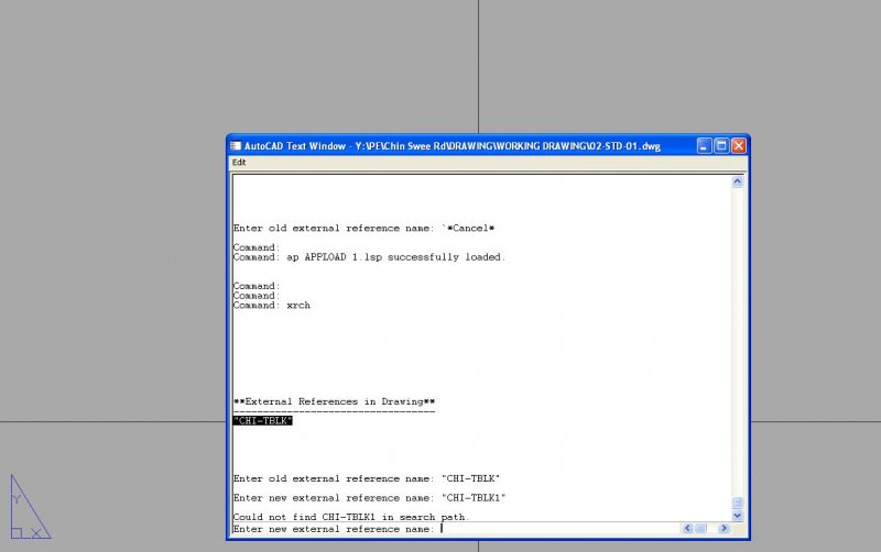

pls find the xref LISP error.i attached the image file.I need to change the xref from the server folder
thanks

Hello! friends
Attached LISP I collected from lisp site, this one excellent works for my xref path change (replace another xref) in copied folder, but the problem is I need to open all dwgs and replaced xref one by one, this one also take so much of time .pls anyone to change this LISP to apply all drawings (64 dwgs) in folder. My xref file name CHI-TBLK in old folder ST10 and new folder ST11. Now I need to change my xref in new folder ST11 (after copy my folder ST10 into ST11 xref path shown in ST10.
My working folder…server
I need to change xref @
Y:\venki\ST11
This is very urgent
Thanks
venki
replace xref.lsp
