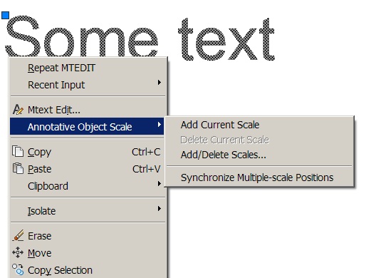

nestly Posted March 20, 2012 Posted March 20, 2012 If the object(s) are annotative, when you select them and right-click, you should see a menu similar to the image below. Text Height = 30 seems very large for Annotative text? As always, posting a drawing almost always yields the fastest and most complete answers. Quote

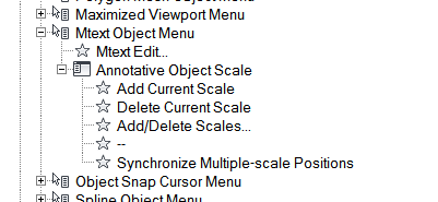

rkent Posted March 20, 2012 Posted March 20, 2012 I am using acm2012. Can't find "Annotative Object Scale" in Right click poped up menu. It isn't in Mechanical but it can be added through the CUI. (Shortcut Menus, Mtext Object Menu, see below for image. can't find "annoscales" either. It was already mentioned, but that was just my lazy way of typing annotative scales. Quote

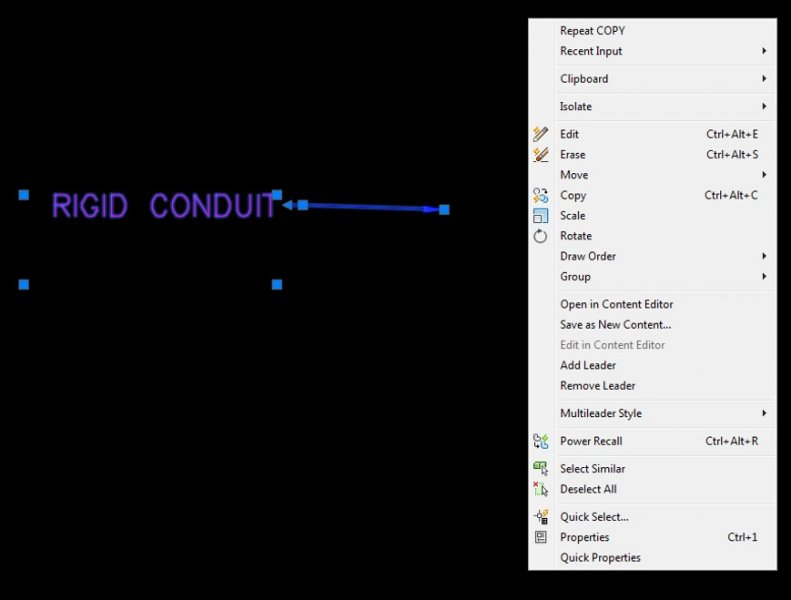

brian_duga Posted March 8, 2017 Posted March 8, 2017 If the object(s) are annotative, when you select them and right-click, you should see a menu similar to the image below. Text Height = 30 seems very large for Annotative text? As always, posting a drawing almost always yields the fastest and most complete answers. [ATTACH=CONFIG]33731[/ATTACH] OK, so nobody has answered this specific to the right click menu missing Annotative Object Scale. Yes, I'm using Mechanical Desktop. See screenshot of there not being the option Annotative Object Scale in the right click menu ... HELP ME! Quote
Ski_Me Posted March 15, 2017 Posted March 15, 2017 OK, so nobody has answered this specific to the right click menu missing Annotative Object Scale. Yes, I'm using Mechanical Desktop. See screenshot of there not being the option Annotative Object Scale in the right click menu ... HELP ME! The text you have selected is not annotative so there will not be an option for annotative scales in the right click menu. Quote
