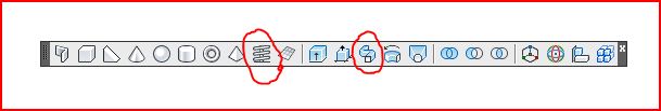

Your description has me thinking that what you may be trying to draw is a HELIX, which you can easily accomplish using the HELIX command on the Modeling Toolbar, or by entering HELIX at the commandline and following the prompts. Sounds like you are trying to model a spring? Once you have your helix, or whatever shape you really are after, you should be able to SWEEP a circle along it, by designating it as the PATH, as suggested by nestly.
I have circled the HELIX and SWEEP tools on the MODELING TOOLBAR.
