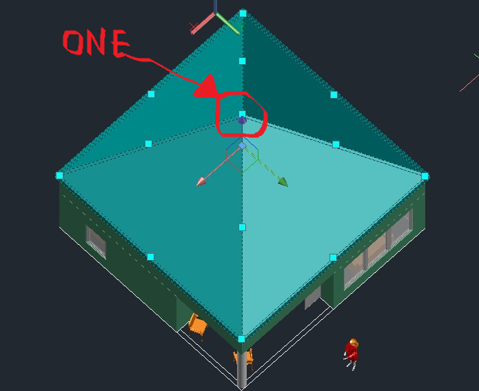

Hello to you all,

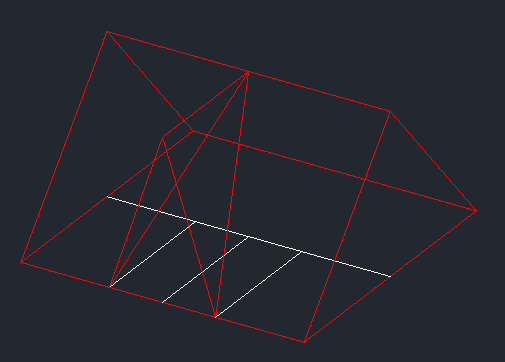

I need some help how to draw my roof correctly. The house has dimension 8 x 8 meters and when I draw the roof with the roof command I get the roof as shown in the picture 2. What I want is the roof to be A HIP roof and not GABLE roof (the first picture). I know that in order to change from Hip to Gable I need to pull the light blue handle on the top. BUT there is only ONE light blue handle to pull?!?! For example when the house dimension is not square (8x8)8) but instead for example 8x9 then I can have 2 light blue handles on the top and then I can easily pull them in the right direction and the roof is changed from being hip roof to being gable roof. But when the house dimension is 8 x 8 I only get ONE light blue handle. How can I change that?
Also, if you look at the picture tONE you can see how I would like my roof to look at the end (red lines). I search a little on the youtube videos regarding roof tutorials but with no luck how to make the roof look like this. How must I draw the roof lines with the ROOF command so that my roof looks like this?
Hope I explained correctly with my text and pictures what I want.
Thanks in advance for all your help.
Best regards to you all,
Miro
Edited by miroslav_s
It is quite simply the geometry. On a perfectly square house, a normal hip roof (all sides equal pitch) will appear as this one does. All four sides are equal.
In order for there to ne a horizontal ridge, either two oposite ends of the roof will have to have a pitch that is not equal to the adjacent sides, or you have to have a house that is not perfectly square.

Well, I see now. My answer seemed backwards because it appears you referred to picture 1, a gable roof, as a hip roof, and referred to picture 2, a hip roof, as a gable. I thought you were having a problem with the hip roof not having a horizontal ridge, which is not possible on a house with 4 equal sides, and 4 equal roof pitch angles.
I wonder why you drew a hip roof and are trying to change it to a gable roof. Why not draw the gable roof from the start? Can you not simply draw two intersecting gable roofs?

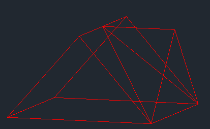

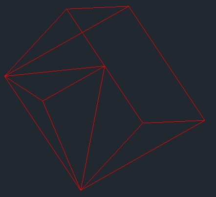

I noticed that the picture in my post above where I am showing how I want my roof to look like is wrong so I made another one. It is a T shaped gable roof, showed in two different views.Can you please instruct me how to draw thisroof?

The G for Gable option isn't telling it that you want a gable roof, but that you want that section of the roof to be a gable, or not. The reason the roof in your second post didn't work was because you were trying to make one with four gables!
The sequence you want is
GABLE
YES
GABLE
NO
GABLE
YES
GABLE NO
And that should get you want.
Your your extensions you'll need to repeat the process to create a second roof.

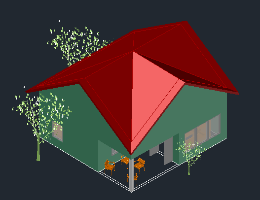

Well ,
I finally did it. I maaged to draw the roof the way I want it to look like. Of course it is all explained really good in “Mastering Autocad Architecture “ book. The trick is to convert the roof to roof slab and then to trim parts you don´t want. Yes!
That looks geat, well done, miroslav_s.
