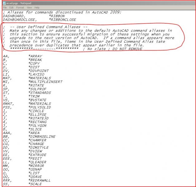

It sounds like whoever usually works at that station has changed the default shortcalls. Are you sure that you want to change them back? Are all of the workstations meant to share shortcalls?
If you are authorized to make changes on this machine, and sure that you want to, it is pretty easy.
If you just need to change a few of them you can use the ALIASEDIT command, or if you need to change them all do the following.
Starting in your menubar TOOLS > CUSTOMIZE > EDIT PROGRAM PARAMETERS.
That will open your acad.pgp settings.
Look at the attachment. If you want to you can copy and paste all of the USER DEFINED COMMAND ALIASES from the computer which you want to be the standard into the acad.pgp file of the computer which you want to standardize. Be careful to paste them into the correct place, as shown. You can delete the USER DEFINED COMMAND ALIASES which you want to get rid of before you paste in the shortcalls which you want to be installed on the noncompliant computer.

Are you running AutoCAD LT 2011 on the problem computer? ALIASEDIT is an Express Tool and not available in LT.
You should be able to get by with running a REPAIR or copy the acad.pgp from a computer that has the default shortcuts.
