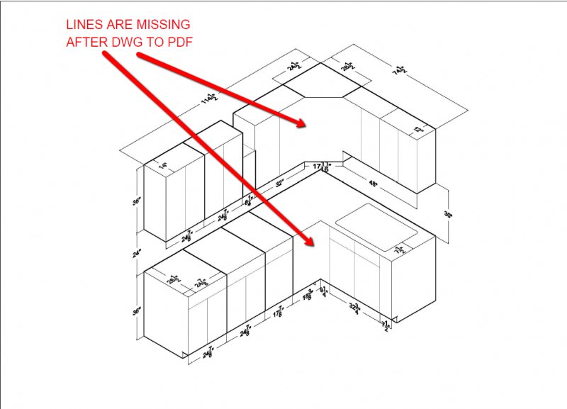

I have a drawing that I converted to pdf for a client and there are a few lines missing that appear in the drawing. Here is screenshot of pdf and also a screenshot of drawing that clearly shows the lines in corners. Does anyone have an idea why this happens? HIDEPRECISION set to 1 didn't help and all objects are on same layer.

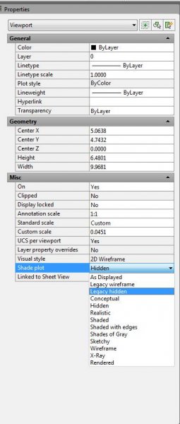

Does it make any difference if ShadePlot is set to LegacyHidden?
I tried using dwg to pdf plot window from my model and that worked. This morning changed viewport setting to Legacy Hidden and that was it. Never would have looked for that menu. Thanks
