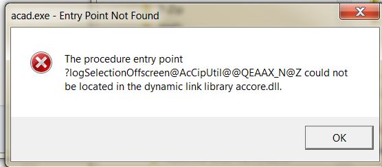

zaphod Posted May 11, 2017 Posted May 11, 2017 thanks, I can't get it to work sadly, it might require windows 10 Quote
rkent Posted May 11, 2017 Posted May 11, 2017 I have W7 and it works fine. When you say you can't get it to work what does that refer to, installing 2017.1.1 or getting the off screen selection to work? Quote
zaphod Posted May 17, 2017 Posted May 17, 2017 well I got it to work, I found out the issue I was having was that I was trying to manually update when I have the "Autodesk Desktop App", when I first opened it I had 11 updates that needed to be installed. Quote
