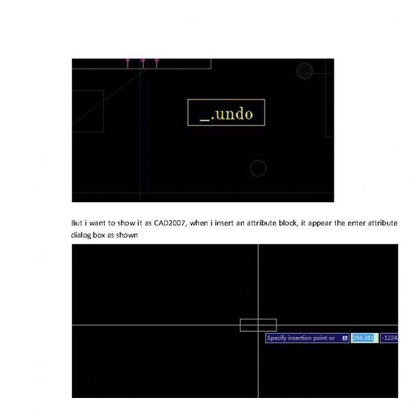

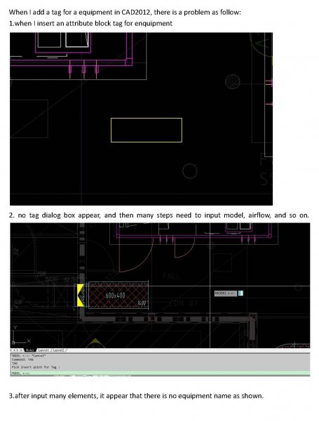

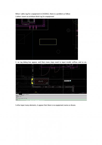

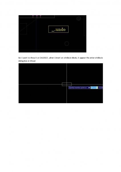

ahub05 Posted April 17, 2012 Posted April 17, 2012 hi all, i also have the problem. and i have set attdia to 1, attreq to 1. but it does not appear the dialog box. and i have to set attdia to 0, it still does not work. by the way i use cad2012 currently. Quote

ahub05 Posted April 19, 2012 Posted April 19, 2012 (edited) Please find the attachment showing my porblem(cad2012 no attribute dialog box appear). i have set attdia & attreq to 1. but still does not work. i do not know what is the problem. Edited April 19, 2012 by ahub05 change photo size Quote
LaneClare Posted April 24, 2012 Posted April 24, 2012 OK; I'm not completely understand your problem, these are the things that I *think* you may be asking: 1) Your blocks work fine in Cad2012, but when using Cad2007, the dialogue box pops up instead of the straightforward prompts in the command line. 2) Your block isn't showing the correct information in 2012, but it is in 2007, or vice versa, or neither version is working the way that you want it to. Possible answers to these issues: 1) You have the dialogue box in 2007, but not in 2012. Do you want the dialogue box, or not? Are you inserting from a toolbar or are you inserting from the command line or the insert button? These things affect how you go about fixing the issue. 2) What information should your block be showing? If it isn't showing what you want it to show, first check the individual attribute settings (in block editor, from the properties menu; select the attribute, and the attribute properties should show. Make sure that the invisible box isn't checked). outside of that, I have no real experience there, and only use 2011, so I don't know about the mixing of the versions. HTH. You should probably start a new thread to ask, since this one isn't getting much traffic, and I'm not really able to help you. Good Luck! Quote
