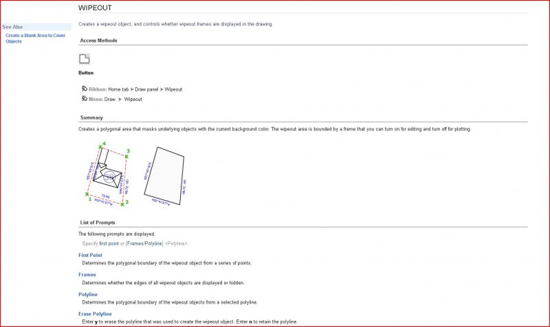

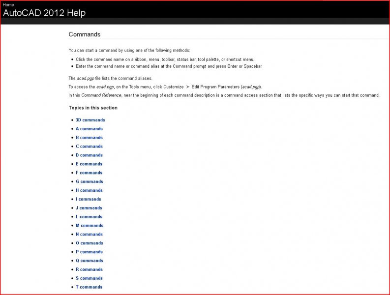

Dadgad Posted March 26, 2012 Posted March 26, 2012 Is there a website that lists all the best commands (favorites) and/or shortcuts for building design? Plus perhaps some killer scripts or macros? Since I am a 1-man show, I learn nothing new from year to year. Commands like Wipeout are awesome, and I wonder how many other commands like it are out there that I don't know about. I have been designing since 1996, and am largely self-taught (lots of books and youtube videos) but I wonder what else is out there. Any suggestions? This might be too general of a question, but I can't help but ask. Thanks again. It is always a good idea to pay attention to any EXPRESS TOOLS, as they tend to run ahead of the pack, and typically the best ones will eventually be incorporated into AUTOCAD, though it might be a few years down the line. If you use your f1 to access the Autocad Help section, take a look at the COMMANDS. Broken down alphabetically, it doesn't take too long to just browse through them and see if there is anything there of conspicuous interest. A good starting point in scouting out unknown commands. The WIPEOUT command info is shown in the attachment. Including some available options you might want to look at. Quote

SLW210 Posted March 26, 2012 Posted March 26, 2012 Wipeouts match the background color. Most have plot problems but that is easily remedied with proper settings. Note: Because a wipeout object is similar to a raster image, it has the same requirements for plotting. You need a raster-capable plotter with either an ADI 4.3 raster-capable driver or the system printer driver. Quote
