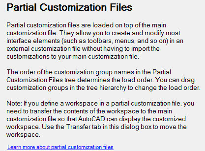

ReMark Posted March 27, 2012 Author Posted March 27, 2012 They should. Did you make your edits to the main body of the CUI file or did you do it under the section with the heading Partial Customization Files > CUSTOM > Toolbars? Or maybe you were not aware of this section of the CUI? Quote
ReMark Posted March 27, 2012 Author Posted March 27, 2012 For your information. Now I must go...my brain hurts. Good luck with your customizations. Quote
