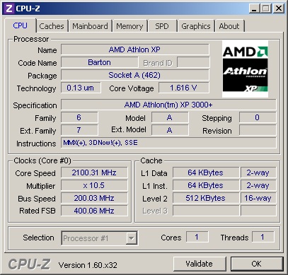

these are my stats
AMD ATHLON XP 3000+
MMX+, 3DNOW, SSE
I don't know whether you're officially unsupported or not, but you're trying to run the latest golly-gee-whiz version of some extremely demanding software on a processor that's been obsolete for almost a decade. On the off chance that you manage to get 2012 to actually start up, you're not going to have a very rewarding experience with it.
