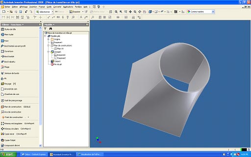

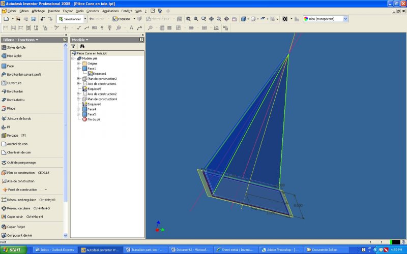

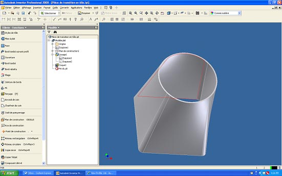

Hello, I modelised in SOLID the first part; I can’t make it in Sheet metal. After I converted it in Sheet metal but sure, I can’t flatten it (to put flat). So, what is the way for a good end a quickly technique for this kind of model in Sheet metal (pyramid-second image, cone, transition part between a circle and a rectangle…etc)? Can someone help me please? Thanks in advance!

You do not have any bends.
You need to loft surface body with bends and then Thicken
or
User Inventor 2010 or later which has a tool to make parts like this.
Hello Mr. Mather, thanks for your help, unfortunatly I can't make it flat! I tried to model the part with bends too (see attached image), but it dosen't work. Can you help me please with an exemple (model)? Maybe I'll understand finally... I'm a biginer in Inventor and I haven't any documantation for study, only the tutorial. I have a student version of Inventor Prof. 2008 in french. Thanks a lot for your help. I have the same problems with the sample formes like pyramide, cone...in Sheet metal modelling. I fyou give me some advises I'll be greatefull.Transiton Part.jpg
