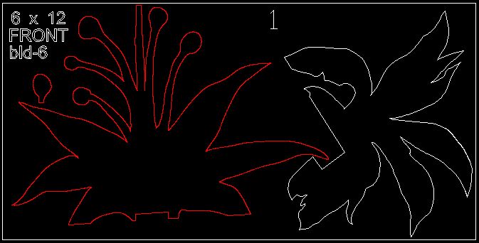

Here is the question I have: I have to sometimes make files for a router table, water jets, and plasma cutters. Some of the shapes are created from splines and or polylines. Our router program and some of the programs that our vendors use (waterjet and plasma cutter) programs that have major trouble with the amount of control points (nodes) that are required to hold that shape as it should be. When I try to remove the nodes in autocad the shape changes.
One of the methods I have to use is to import the DXF file into Corel Draw X3 and remove all the extra nodes that the program will allow me to delete without changing the shape of the item. This works sometimes depending on the program that the vendor is using. I have to do different things for different vendors, and as I said this only works 50 percent of the time, and I will not know if it worked or not, until the vendor starts complaining about open files or not. On one occasion the final product came in from the vendor, and it was a mess, inside corners were blown out in large circles, and outside corners were rounded off into large circles.

Usually when we are creating our files, we have no idea whether or not they will be used in house or out of house. We usually find out after the screaming and flailing starts. In one case I did contact the manufacturer of the Program used to run the vendor's waterjet, he was dumbfounded. On this particular item, the artwork was first created in Adobe Illustrator, then exported out of AI to a Dwg file, used in the drawing creation itself, then the artwork was converted to DXF. Then I imported into Corel Draw, remove any nodes that I can, close nodes that need close, then export it to a DXF file again, and then sent to production. Production decided that this particualr item needed to be cut out of house, this was followed by 2 weeks of trial and error.
I have had issues where polylines and splines have changed shape by saving them to a Version 12 DXF. Sometimes dramatically. Usually I do not like to go much past a 2000 DXF.
I have attached a PDF of what the Vendor Printed out from his program, and a screenshot from my computer screen.

Actually AutoCAD may be contributing to the problem - it is not just a CNC related issue. You might try searching for some lisp files that "weed" the polyline or the spline. Basically they work by establishing a toleranced corridor that the modified spline/PLine are allowed to conform to. Then as it parse the nodes it will create a new (or modified) spline/polyline with fewer nodes.
I've done this in my own programming and I've been able to knock 360 nodes down to 10-12 nodes.

Right you are, I forgot I used to also run WEED.LSP as well. I still have a copy, though haven't used it lately on newer version of AutoCAD. Hopefully it will work for you.

Sorry About the font. I will try this weed.lsp, and see if it works for me.
