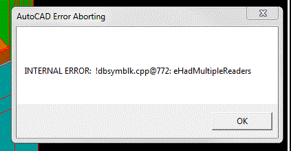

MikeP Posted April 2, 2012 Posted April 2, 2012 i get this then it crashes. its been happening a lot lately. Quote
ReMark Posted April 2, 2012 Posted April 2, 2012 Do you have all service packs installed? Are you using any custom lisp routines that you recently developed or downloaded? Quote
MikeP Posted April 2, 2012 Author Posted April 2, 2012 I have a number of lisp, but nothing new. as far as i know i have the latest service pack. this has been happening out of no where though. Quote
SLW210 Posted April 2, 2012 Posted April 2, 2012 What are you doing when this happens? Is this with one drawing, a few drawings or all drawings? Quote
MikeP Posted April 2, 2012 Author Posted April 2, 2012 any drawing apparently. ill go to change views. I just went to zoom into a view port in paper space and then it crashed. this never has happened like this before Quote
ReMark Posted April 2, 2012 Posted April 2, 2012 Any drawing? Doesn't sound good. Might consider running the REPAIR option and see if that fixes it. Quote
SLW210 Posted April 2, 2012 Posted April 2, 2012 Does this usually happen using zoom or pan commands? You may need to run a repair. Do you have hardware acceleration enabled? Latest graphics driver? Quote
MikeP Posted April 2, 2012 Author Posted April 2, 2012 hardware accel is on. I click check for updates, there was a new one, so i updated it via the 3dcongif window. Quote
ReMark Posted April 2, 2012 Posted April 2, 2012 Please don't keep us in suspense. And then what happened? Anything? Nothing? Quote
MikeP Posted April 2, 2012 Author Posted April 2, 2012 no far nothing. its a random crash/error. and not at all predictable Quote
Murph_map Posted April 2, 2012 Posted April 2, 2012 no far nothing. its a random crash/error. and not at all predictable I would start with cleaning up your temp file folder. From the start button > RUN type in %temp% then enter, now delete all files in that folder that windows lets you. Next I would see what other apps are running when you get the crashes, look in the events logs from the control panel> Admim Tools > Event Viewer. Also are you opening/using dwgs from a network drive? Quote
MikeP Posted April 3, 2012 Author Posted April 3, 2012 well I had 19Gigs in my temp folder, so im cleaning that up. I will keep an eye on the event log and post the latest reason why it crashed. Thanks Quote
MikeP Posted April 3, 2012 Author Posted April 3, 2012 Here is my latest error Log Name: Application Source: Application Error Date: 4/2/2012 5:42:12 PM Event ID: 1000 Task Category: (100) Level: Error Keywords: Classic User: N/A Computer: SHOP666.PMI.LOCAL Description: Faulting application name: WSCommCntr1.exe, version: 17.2.56.0, time stamp: 0x47ae8d9e Faulting module name: unknown, version: 0.0.0.0, time stamp: 0x00000000 Exception code: 0xc0000005 Fault offset: 0x002e0031 Faulting process id: 0x420 Faulting application start time: 0x01cd10cd2d0f9fc8 Faulting application path: C:\Program Files (x86)\Common Files\Autodesk Shared\WSCommCntr1.exe Faulting module path: unknown Report Id: b42126b2-7d0c-11e1-8802-b8ac6f29e12b Event Xml: 1000 2 100 0x80000000000000 19299 Application SHOP666.PMI.LOCAL WSCommCntr1.exe 17.2.56.0 47ae8d9e unknown 0.0.0.0 00000000 c0000005 002e0031 420 01cd10cd2d0f9fc8 C:\Program Files (x86)\Common Files\Autodesk Shared\WSCommCntr1.exe unknown b42126b2-7d0c-11e1-8802-b8ac6f29e12b Quote
monkey7 Posted April 3, 2012 Posted April 3, 2012 WSCommCntr1.exe is the AutoCAD communication center. Disabling it might at least solve the direct problem: http://www.cadforum.cz/cadforum_en/running-process-wscommcntr1-exe-tip6914 Quote
MikeP Posted April 3, 2012 Author Posted April 3, 2012 WSCommCntr1.exe is the AutoCAD communication center. Disabling it might at least solve the direct problem: http://www.cadforum.cz/cadforum_en/running-process-wscommcntr1-exe-tip6914 turned this off, yet the "WSCommCntr1" still shows up in the task manager when I start CAD Quote
ReMark Posted April 3, 2012 Posted April 3, 2012 You've got to "kill" to make sure it is really dead. Did you? Quote
SLW210 Posted April 3, 2012 Posted April 3, 2012 Try THIS to kill SPYCENTER (a.k.a. infocenter). Quote
MikeP Posted April 3, 2012 Author Posted April 3, 2012 You've got to "kill" to make sure it is really dead. Did you? you man double tap? Quote
ReMark Posted April 3, 2012 Posted April 3, 2012 you man double tap? Yes. You want it "dead" not just "shut off". Quote
