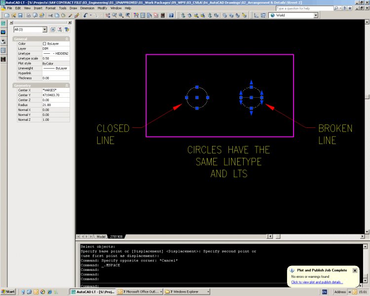

WERDNA Posted April 2, 2012 Posted April 2, 2012 Can anyone tell me why a circle is not showing the particular linetype (no matter what scale I adjust it to) until I break the circle line? Quote

WERDNA Posted April 3, 2012 Author Posted April 3, 2012 Hope this makes it a bit clearer? For some reason the dashed line will not show-up without breaking the line, second image showing the pick boxes. Quote
rkent Posted April 3, 2012 Posted April 3, 2012 Your circles are a long ways from 0,0; you have ltscale set to 0.01, and celtscale set to 0.5. Maybe all of that contributes to your problem. What scale is your viewport set to? Much easier to trouble shoot when you post the actual drawing. Quote

WERDNA Posted April 5, 2012 Author Posted April 5, 2012 Apologies, must of deleted the circles after the post. That was the file I used to show the problem, I think rkent cracked it with the distance from origin suggestion. I positioned one of the blocks at 0,0 and when viewed within a viewport the hidden circular lines are coming through dashed. Thanks to everyone for their assistance. Quote
