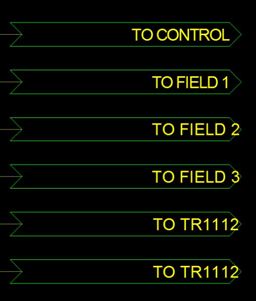

I haven't added a screen shot to a post yet this might not work but I will give it a go
That is kind of hard to see sorry. But you can see how on the top two the text is all the way in the arrow and the bottom 4 the last number is hanging out. I click on the text/attribute and the grip shows up, click on the grip twice shifts the text back to the left where it is suppose to be. These ones are not as bad as some that hang/shift half the length of the text to the right.
On that one it is right Justiified, but it seems to also happen when things are center and left also
It always is correct in 2011?
