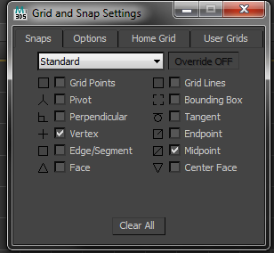

anyways to edit your snap settings..
right click this button.. on the tool bar.. it should be on top by default..
when it is highlighted blue it means your Snaps are enabled.. to disable you can click it to make it look grey. or you can press S on the keyboard to quickly toggle on/off..
Once you right click it this should appear.
check and uncheck what you want and dont want.. i recommend enabling only midpoint and vertex Snap otion to be able to effectively snap to your objective..
to snap to the center.. simply make sure that the MIDPOINT option is checked.
now just select your vertex in any viewport "front, back, top, perspective"
and drag to the midpoint..
Another technique.. is more complicated.... simply do some math do find the XYZ coordinate of the midpoint..
but that is a waste of time since the SNAP TOOL does everything for you.

but yeah true no way to snap to GRID midpoint only to OBJECT midpoint UNLESS...
he creates a plane that is centered and has segments matching the grid :D now we are talking :twisted:
