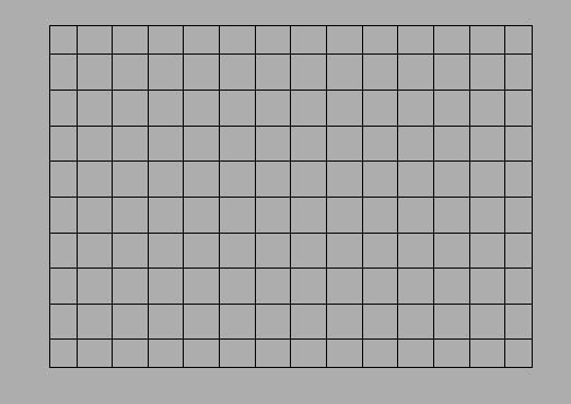

alternativegem Posted April 6, 2012 Posted April 6, 2012 I am running 2002 cad and am looking for a 595x595mm ceiling grid 1 inch or 24mm grid width - hmmm have been looking all day on the web zzzzzzzzzzzzzzzzz Preferably looking for the .pat file if my thinking is straight - thanks in advance Quote
eldon Posted April 6, 2012 Posted April 6, 2012 I am not sure what is so special about a ceiling hatch, but if you want a simple square grid hatch, then have you tried the NET predefined hatch pattern? The distance between lines is adjustable with the scale factor. Quote
alternativegem Posted April 6, 2012 Author Posted April 6, 2012 I am not sure what is so special about a ceiling hatch, but if you want a simple square grid hatch, then have you tried the NET predefined hatch pattern? The distance between lines is adjustable with the scale factor. Thank you for the reply. - sorry I am new to this stuff, can you tell me what is and where do I find the NET hatch pattern. A ceiling grid is a frame 24 mm wide with tiles sitting in each 600 x 600 hols that the frame creates. Once again thank you. Quote
Dana W Posted April 7, 2012 Posted April 7, 2012 I don't mean to sound flip, but could you not have drawn the required grid in the time that has elapsed? You can't manipulate a hatch patern well enough to actually use it for a ceiling grid anyway. There are no snaps to the internal lines of a hatch, and it is nearly impossible to align a hatch pattern to anything other than making it fit into a boundary. Quote
alternativegem Posted April 7, 2012 Author Posted April 7, 2012 you are of course correct - But i am new and self-taught with CAD, therefore one failure has me turning other stones. I think that I will be drawing the inside of commercial buildings for a little while yet, do your have any suggestions of where to find other building related files? Thank you for your interest. Quote
eldon Posted April 7, 2012 Posted April 7, 2012 If you scrolled down this page to look at "Similar threads", there is a very good tip at this thread Set the SNAPBASE to the centre of the room and the grid is evenly aligned to the edges. AND all hatch line intersections respond to the OSNAP Intersection. Just go and find out about the HATCH command. Quote

daft vader Posted April 7, 2012 Posted April 7, 2012 a good lisp will do the job try this thread http://www.cadtutor.net/forum/showthread.php?54259-how-to-auto-insert-ceiling-grids-to-room&highlight=ceiling+grid Quote
samchums26 Posted April 9, 2012 Posted April 9, 2012 Try this, 595x8=4760. hatch the room and change the hatch origin to the center of the room and change the scale of the hatch to 4760. Have a nice day Quote
samchums26 Posted April 9, 2012 Posted April 9, 2012 I forgot to explain how did i get the multiplier 8. If you try to make a net hatch 595, the actual net hatch measurement will be 8 times smaller in the scale you provide for the hatch. so, to get the exact measurement, you need to multiply 595 to 8 times and then use the result in the hatch scale. Quote
