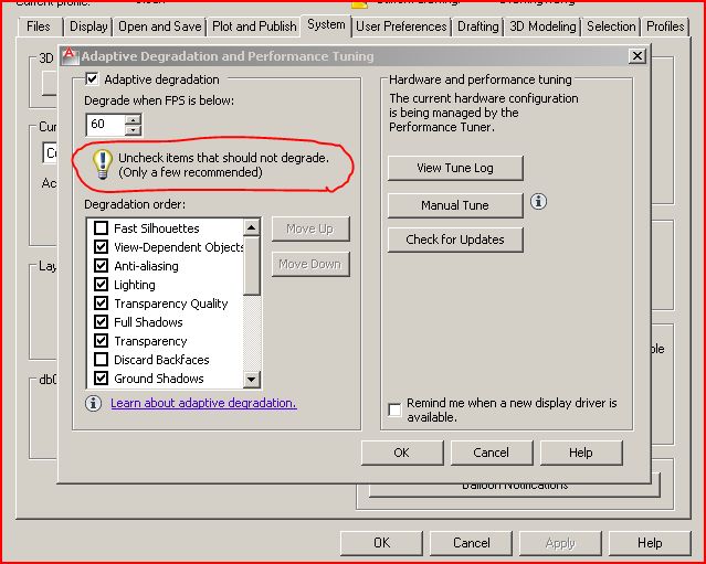

If you have not already set up ADAPTIVE DEGRADATION, then you probably should. In that way if the demands on your system are too great you can direct it to prioritize the features of your display which are the most relevant, and generally speed up your performance by essentially turning off things of little importance.
As Charlie Sheen would say, 'take the degradation challenge!'
