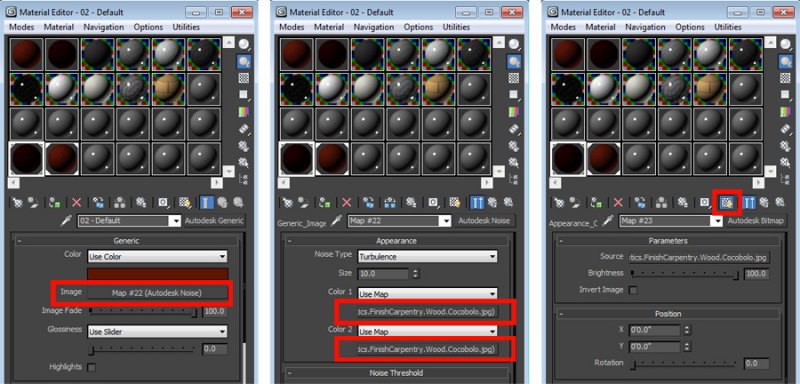

In order to see the materials in the viewport you need to go into the material properties and set the source images to display in viewport.
AH WOW... i understood the part about display in viewport, what i didnt catch the first time i read this was to "go to the source images" and set them to display in viewport..
GENIUS my friend, pure genius.
Problem solved 8)
