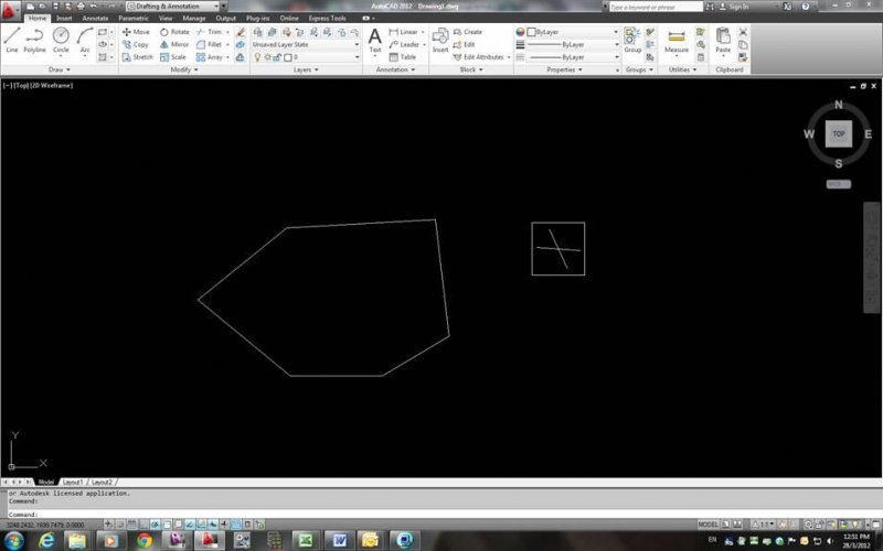

ShadabKhan Posted April 7, 2012 Posted April 7, 2012 Whenever I want to open AutoCAD file some lisp files like acad.fas and acaddoc.fas generate automatically and these file has corrupt my AutoCAD Hatching and lintypes. I have download an antivirus for deleting these files but that antivirus is not wotking properly. i am attaching a file kindly see that is the virus list which shown on AutoCAD Screen 24 Provinces and Municipalities of Cambodia have been protected with anti virus software. this message shown Quote

ShadabKhan Posted April 9, 2012 Author Posted April 9, 2012 The solution to your problem is contained within this thread. Read ALL of it. And try to remain calm. The problem can be solved. http://www.cadtutor.net/forum/showthread.php?58117-acad-viruse&highlight=acad.vlx Dear my Problem is still. I have downloaded killworm.fas and scan my autocad file using this file but the problem is my autocad change all system value automatically. when i open autocad by default zoom value is 80 after doing some work zoom value decrease and set to 3 and many system value has changed automatically. killword does not solve my whole problem. I have attached jpg file my autocad cusor change like this kindly see Quote
