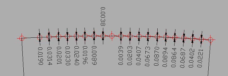

I am using autocad 2011 (fairly new to it).
I am having trouble taking a dimension from a node to the edge of an arc.
Attached is a diagram of what i am trying to achieve, i have also attached my actual dwg file.
If you look into the dwg file and zoom in you will see that my arrows do not point to the edge of the arc.
Can anyone shed any light on this?

Use the Osnaps "Node" for the Point, and "Perpendicular" to the edge of the arc.

Why have you drawn the line? If you must draw the line, then the dimension (distance) is from the point (node) to the intersection of the line with the arc
From the geometric properties of a circle, any line perpendicular to the circle must pass through the centre of the circle.
So draw the dimension from the point (node), then perpendicular to the arc. This gives you the dimension (distance) that you want, without drawing any temporary lines.

I have enabled Node and Perpendicular on Osnaps and then dimensioned from the node until i saw the perpendicular symbol.
When i zoomed in as much as i could the arrow that should have been pointing to the arc was in fact pointing above - why is that.
In the attachment (dwg file) i get a dimension of 0.0203 - But i think this is incorrect.
Why does the arrow not point directly at the arc??

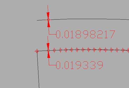

Hi Eldon
If we just focus on the first point on the left which has a dimension of 0.0190.
When I dimension this point to the arc i get a value of 0.0190.
Then if I set the precision to the max i.e. to 6 decimal places then this dimension becomes 0.018982.
I then zoom in as far as I can, regen and able to zoom in further.
Then if i drag the top of the arrow down towards the arc, the dimension then becomes 0.0193339.
If what you say is true that is the dimension measured from the point to the arc at right angle then my dimension should be the same regardless of what the precision is?
I hope this makes sense.
Attached is my dwg showing my dimension value of 0.019339.
Thanks for your input.
Regards
Dimension Problem.dwg
Then if i drag the top of the arrow down towards the arc...
Sounds to me like you might be dragging the defpoint rather than (or with) the arrow.
I am not sure why you are moving the dimension after it has been drawn. You must trust the Osnaps accuracy.
The dimension that you have dragged is no longer perpendicular to the arc, because you have eye-balled it in, therefore the dimension that it shows is nonsense. In fact if you draw a line from the upper end of the arrow line to the lower end of the arrow line, and then extend this line towards the centre of the arc, it now misses the centre point by nearly 2 units.
In the picture, I have copied the one node and the arc, and dimensioned it showing 8 places of decimals. So the dimension of 0.0190 is correct when you take four decimal places.
I think that your problem is with your usage, rather than with the dimension. DO NOT drag dimensions around willy-nilly to agree with something that you appear to see on the screen. Trust the Osnaps :D
I have just zoomed in to your dimension at the top end, and your dimension is no longer to the node.
