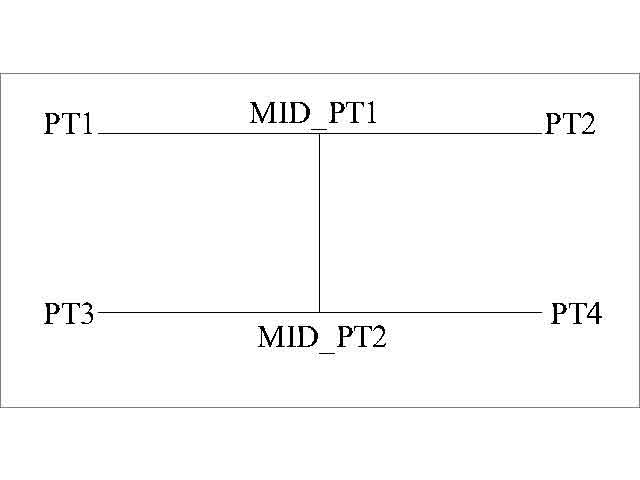

Bill Tillman Posted April 9, 2012 Posted April 9, 2012 My LISP program creates many lines doing it's work. I'm at an area where two of the lines which get drawn need to be connected my a single line which goes from the midpoint of one to the midpoint of the other. (command "._LINE" pt1 pt2 "") (setq l1 (entlast)) (command "._LINE" pt3 pt4 "") (setq l2 (entlast)) (command "._LINE "mid" l1 "mid" l2" "") This of course does not work. In searching I don't seem to come up with any information on how to select the midpoint of a line using LISP. Quote

godofcad Posted April 10, 2012 Posted April 10, 2012 I think it vl help to u ....... Try this (setq pt1 (getpoint)) (setq pt2 (getpoint)) (command "line" pt1 pt2 "") (setq L1(entget(entlast))) (setq mid_pt1(polar pt1 (angle pt1 pt2) (/ (distance pt1 pt2) 2))) (setq pt3(getpoint)) (setq pt4(getpoint)) (command "line" pt3 pt4 "") (setq l2(entget(entlast))) (setq mid_pt2(polar pt3 (angle pt3 pt4) (/ (distance pt3 pt4) 2))) (command "line" mid_pt1 mid_pt2 "") Quote
