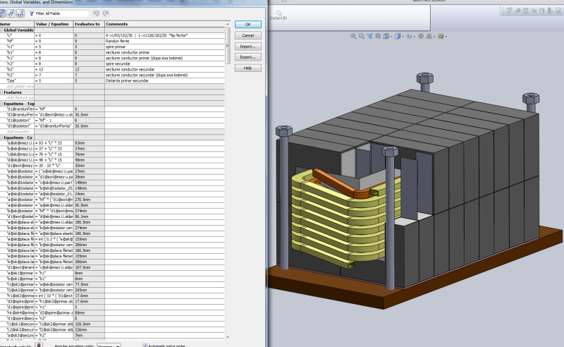

fuccaro Posted May 11, 2012 Author Posted May 11, 2012 Lot of thanks, slowly I make progresses. I managed to control the part dimensions with assembly equations. No If functions, just global variables referring sketch dimensions, other part's sketch dimensions refer to those global variables... For the moment that's a nightmare for me, but I keep learning. My next question: how can I change the part's configuration changing the assembly variables? I read that is possible, but I can’t achieve it. Quote

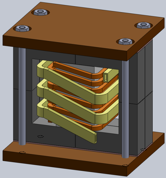

fuccaro Posted May 31, 2012 Author Posted May 31, 2012 I am a happy man! I open the assembly document, I expand the "equations" and I change the values. I can change the ferrite cores (we use 2 sizes), the windings, the distance between them..., I rebuild the model and I got a whole new construction. All the parts are resized and I only need to adjust a little bit the drawings. I worked more than a week on my first project, now it takes less than a day. Thanks again for all the help! Quote
