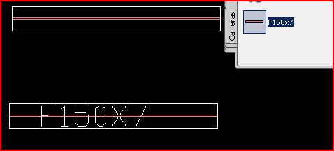

You can't assign layers to elements of a multiline, although you can assign linetypes and colors. The only way I see to accomplish something like that would be to create blocks, which can include layer information, and create a tool palette specially for them. Once you have created them and pasted them onto the tool palette you can specify in the properties for each block, that they be exploded on insertion, at which point they will be on their correct component layers, although you will have sacrificed the multiline functionality.

The idea is for machining purposes a particular contour needs to be drawn on a specific layer. This layer represents the tool number and the depth of the cut. For thicker materials two contours are required. one "contour/layer name" as the first pass at half depth another at full depth. Currently i have to draw in one layer then trace over in the second layer. i do not think the use of a block will be appropriate as all parts have different shapes.
The thought behind the multi line was i give a second element a zero offset. As it seems i can not change the elements of a ML maybe someone knows if i am able to draw two Plines at once both with a different layer.
Why not use the COPYTOLAYER command? Copying to layer Second Pass or whatever. No need to trace it.
