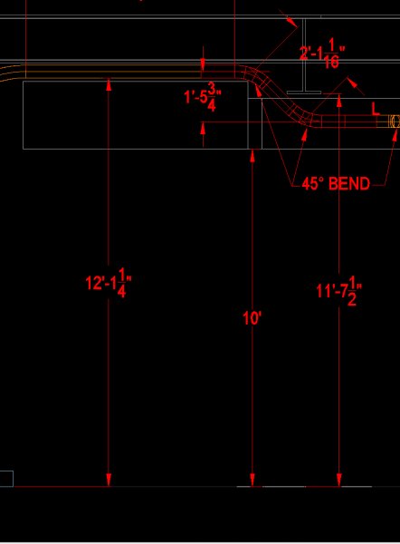

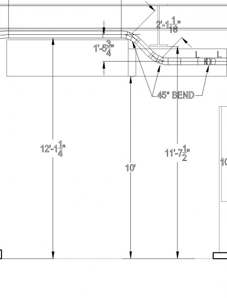

Hey guys I just switched over to ACAD MEP 2012 and I've noticed my text isn't filled in when I plot drawings. Attached are pictures of what I'm referring to... the first pic is what it should look like the second is what the final product is... Any help would be greatly appreciated.
You should ensure that TEXTFILL system variable is set to 1.
