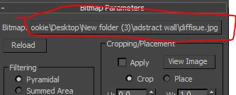

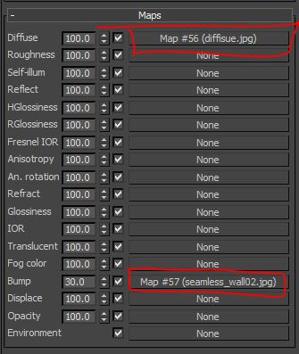

remizana Posted July 5, 2013 Posted July 5, 2013 Dear cad64 I've installed max 2013 and no problem. But after installing vray 2.03.01 for max3013, in my material slot , all vray material appears black, while it was OK in max2012 and vray2.0 what is the problem? Quote
Raudel Solis Posted July 6, 2013 Author Posted July 6, 2013 Dear cad64I've installed max 2013 and no problem. But after installing vray 2.03.01 for max3013, in my material slot , all vray material appears black, while it was OK in max2012 and vray2.0 what is the problem? Your file paths are probably missing, or wrong go into a material and try to relocate the diffuse map if applicable if the material bitmap points to the wrong place then find it again, and repeat for all the other missing bitmaps A common mistake would be that the render isn't set to vray- I doubt that's the problem. Quote
remizana Posted July 6, 2013 Posted July 6, 2013 when the render engine is set to scanline all 3ds materials appear right but vray's material are black. and then when i set the render engine and material editor to vray adv 2.30.01 ;all material turn into black! I'm a junior and no idea hoe to relocate the diffuse map. It's very kind of you if let me know. Quote
Raudel Solis Posted July 6, 2013 Author Posted July 6, 2013 I'm a junior and no idea hoe to relocate the diffuse map. It's very kind of you if let me know. Just locate the appropriate image for each material. if after doing that the material doesn't return to normal then it's something else. Quote
Cad64 Posted July 6, 2013 Posted July 6, 2013 Dear cad64I've installed max 2013 and no problem. But after installing vray 2.03.01 for max3013, in my material slot , all vray material appears black, while it was OK in max2012 and vray2.0 what is the problem? You say the materials are all black in the material slots, but what about in the viewport? Are they black there as well? And what about when you render? Is everything black or do you see the materials? If you see the materials displayed correctly in the viewport and/or when you render, it's not a problem with your file paths. I don't use Vray, but I found this reply to a similar question on another forum. Maybe it will help: In the material editor under options, there is a check box that says 'use real-world map size for geometry samples' This box needs to be unchecked. Quote
spittle Posted July 9, 2013 Posted July 9, 2013 I never noticed before but it's the same for me. Vray won't render some of the previews i.e. when you are scrolling through the available maps/materials, but they work (the vray compatible ones of course) and you get the preview if you drag it into slate material editor for example. Or if you add an image file to the bitmap node then it no longer has a black preview. In a way it's a good thing - means your material editor doesn't have to render them which you may appreciate on a large scene. Was that the problem? Quote
