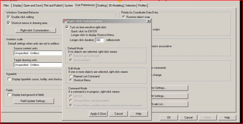

Hi, I have a doubt regarding Mouse click actions in Autocad. Is there any possibilities to set a autocad command or lisp command to mouse right click. I mean tha if i click mouse right button automatically command need to execute. Presently in autocad when i click right mouse button it shows popup window(In this window showslast command and recent commands list). But i required need to execute assigned command without popup widow. Sorry for my english.

You would have to edit your CUI to execute the new "assigned" command. Look at Mouse Buttons > Click.
You can do this quite easily. You will need to open and tune your OPTIONS. Lots of ways to open your OPTIONS. You will likely find it at the bottom of your right click shortcut menu, or you can right click inside your COMMANDLINE and select it there. OP typed into your commandline will probably do it too.

The attachment shows you where to find the RIGHT CLICK CUSTOMIZATION settings. Review and choose appropriate settings to taste. I like to use the TIME SENSITIVE right click option, it is a matter of personal preference, set yours here.
+1 on the Time Sensitive idea as it gives you both, I hate not being able to get the right-click at all. That way a quick right-click is as if you pressed Enter / Spacebar. A click-and-hold would open the pop-up.

It was probably some sort of toggle on the ShortCutMenu variable. Or even also the ShortcutMenuDuration. These are basically what you're changing in the Options dialog as Dadgad's shown.
