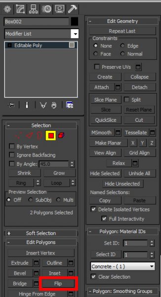

Pexzor Posted April 14, 2012 Posted April 14, 2012 Hello peeps I have started learning 3ds max a month ago and in few cases now I've been having problems with rendering some objects. After the render they become see trough. For example here: I have made 2 dents with 2 different radius spheres in to the object on the right then I made a copy on the left, took those inner polygons and extruded up. Then I tweaked it a bit more by extruding some parts a bit more upwards to get this object. But then when I render it I get this. Does anyone have any idea what I'm doing wrong or how to make it render properly? Quote

Cad64 Posted April 18, 2012 Posted April 18, 2012 Hmmmmm, Ok, the 3rd picture was not there when I was here earlier. There were only 2 images. That's weird. Anyway, the reason the objects appear see through in the render is because your polygons are flipped. What you need to do is select all the polygons in your model and click the "Flip" button Quote
Pexzor Posted April 18, 2012 Author Posted April 18, 2012 Haaa amazing, that worked like a charm. Thank you allot. I'm gonna work on more clean modelling, could you suggest any tutorials that can help me with that ? Quote
